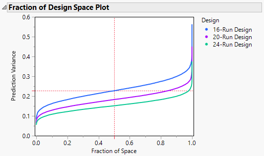

The Compare Designs platform compares two or three designs simultaneously to explore and evaluate their performance. Diagnostics show how the designs perform relative to each other and how they perform in an absolute sense. To compare designs relative to your specific needs, you can change the terms in the assumed model and in the alias terms list.
Figure 15.1
Comparing Three Designs with Different Run Sizes
